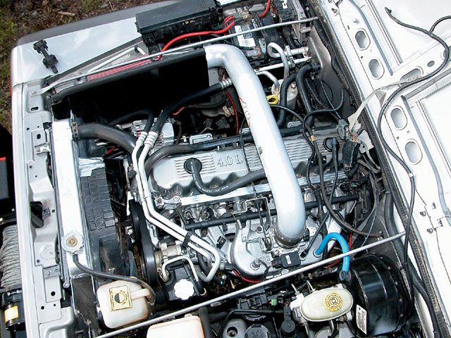

Plus 1. I believe the 'orifice' still originated from the valve cover? ...but I don't have a 4.0 that new to confirm. ;)
Yep, it's still there on this 2000, 4.0
