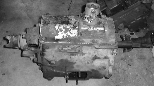

Likely older than you were told. The cast iron transmissions were the NP435, looking like this:

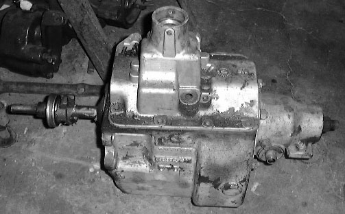

and NP4530, looking like this:
