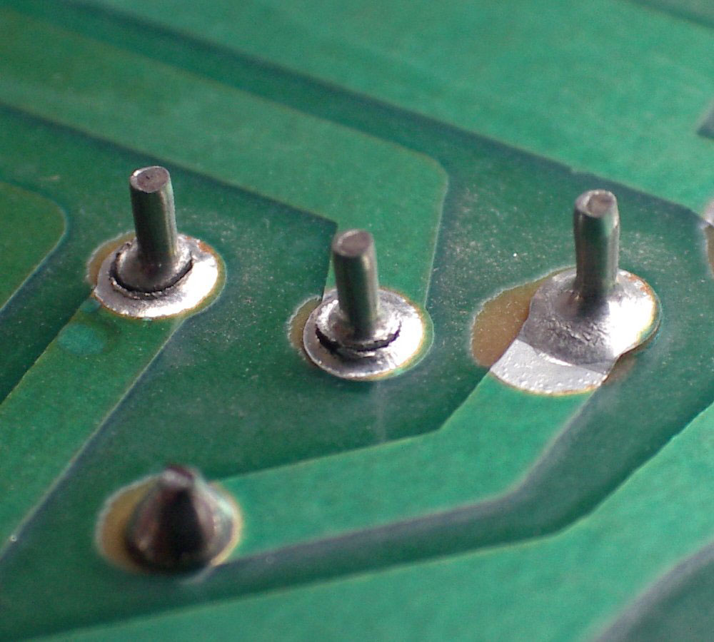

A 'no start' can also be caused by the cluster being dead. This may be the whole problem.
Remove the cluster & touch up the fractured solder joints on the circuit board.
