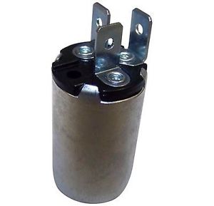

Last thing is very minor, but I noticed there are a couple little lights that shine on the ignition and headlight switch when getting in the car at night. Very cool idea, but they don't seem to work consistently. I'm curious how they work so that I can make them function properly. I'm speculating that they are supposed to come on when the door opens and then stay on for a minute or so after the door is shut.

There is a time delay relay for lighting important areas for a moment after the dome light goes out. It may be failing. It can come apart for inspection and contact cleaning, etc. if you want to try a Hail Mary on it first. It may be plugged into the fuse block or hanging around the steering column under the dash?
