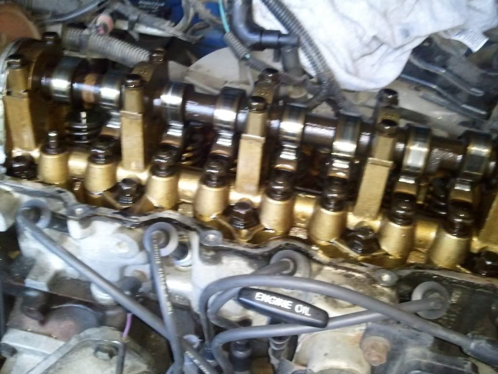

Short and skinny, the Daytona puked up it's no. 1 exhaust valve rocker arm. Doesn't look like anything got damaged or destroyed, the rocker just popped out. My inclination is to figure out how to stuff it back in, but what made it go in the first place and how do I avoid that happening again?
The car is a 91 4 banger (non-turbo) and has been driven by my wife's dad it's whole life, so yeah, the little old lady story, and it's only got about 76K miles on it.
If I can figure out what happened to the pictures that I was going to use for this post, I'll put 'em up. For now, use your imagination, the very first rocker on the passenger (timing belt) side of the engine, laying at the back of the head and everything else looking in order. A couple small scratches on the side of the cam, but nothing that I can see where the roller contacts the lobe.

The cam followers don't tend to 'fall out' normally. If it was over reved and the valves 'floated' then it's possible that it could have popped out. Another possibility is a collapsed lifter. The best way to reinstall this is to remove the cam and place the rocker back into position. If it's a follower and not a roller 'follower' then they 'must' be put back on the cam lobe that they originally work with otherwise the wear pattern will be different.
Once you get the cam out you can lift the lifters one at a time and measure their height against each other. They should all be about the same height. If that one lifter is shorter then you have identified your problem. Replace all the lifters just to be safe.

Ok, the pictures finally showed up from my phone.
No, it wasn't over revved, I've been driving the car for the last several months and haven't thrashed on it at all--ever. So it didn't float the valves.
It made a really strange rattling noise last week when I started it to go to work, but settled down almost right away and ran good for the next week. Then when I started it to go to lunch the other day, it started popping and running rough, which is when I would think the rocker exited stage left.

It now sounds like a lifter took a dump more than anything else.
To remove the cam (and change the timing belt while you're at it - why not?) pull the belts and untension the timing belt tensioner. Remove the timing belt and then there are (IIRC) five caps. Remove them and the cam lifts out. DON'T mix up the cam journals. They must go back in order. Order some seals for the cam if you want and replace them too while you're at it. It's easy to strip the threads if you over torque the bolts. Use a torque wrench and tighten them to the proper torque. I'll have to look up that value.

You have a roller follower cam and followers. The lifters have nothing to do with the cam wear. If you pull the cam, pull the lifters and because they are roller they are not as prone to wearing the cam in a pattern as normal followers are. So the followers/rockers 'may' be put back in any order but number them just the same and install them back on the lobe they came off.
Next, pump up the lifters manually before you install them to get them full of oil. Install them after you pull the old ones out. Be careful that the big cylinder is the same diameter and height as the ones coming out. Then, once it's all back together pour some oil on the cam just because and crank it. You should be just fine.

Same thing happened to my 2.5 except it was the #4 rocker arm. What happened with mine was the lifter collapsed and the spring got all gummed up with carbon. What we did was use carborater cleaner in the spring to losen it up again so we could push it down to put the rocker arm back in along with a new lifter. We didnt need to move the camshaft at all.

Roller cams don't need the cam break-in stuff, but extra grease on the cam and roller rockers is aways a good thing at start-up, I like using simple moly wheel bearing grease, just wipe some all over everything and forget it, don't really care for that red "cam lube", just too thin for me. If you don't want the hassle of pulling the cam and all that, compress the valve and spring and slip the rocker in there. Rotate the cam so you are at the bottom of the lobe, but even before you do this, pull that lifter and make sure there isn't a problem with is, it is the pivot point adjustment to keep the rockers in place, if they get junk in them and go flat, that's when they will come off because the pivot point is not tight enough to keep them in place. Sure saves a lot of time pulling a whole came out, unless you want to do all that work.
We had to use a pry bar lol
Nothing wrong with using a prybar. There is actually a pickle-fork looking tool to do it, gently pressing on the valve spring to get the valve down far enough to clear, the ends of the fork rest on the underside of the camshaft, just gently pry to compress the spring, slip the rocker in.
Wow, the Daytona's been sitting in the garage for a long time according to the start of this post! My buddy just asked for his spring compressor back so I got on the car last night and stuffed the new lifter and original rocker arm back in. It went in scary easy--made me nervous with how quick it went.
I decided to turn the engine over to make sure all was right before I put the valve cover back on and guess what----ping, clang, pow---it shot another rocker arm out! I'm gonna guess it froze up in the last couple months of sitting, so I'm going to order a new set of lifters and swap them all out.

Check your oil carefully for any signs of moisture or antifreeze. I can't understand what is causing these to freeze up but I suspect contaminated oil. I know of many cars that have sat for years without being started and they did not have this problem when they were started after sitting for a long time.
