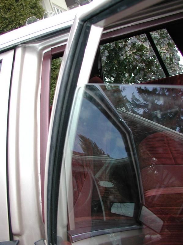

here's the FRONT edge of the rear door glass, with the black felt all around, like it's supposed to be
and here's the REAR edge of the rear door glass, with a raw metal track. looks like the felt is moving with the window, just like you said
it's possible to crank the glass up and down, but it's really tight, almost feels like the crank might snap off.

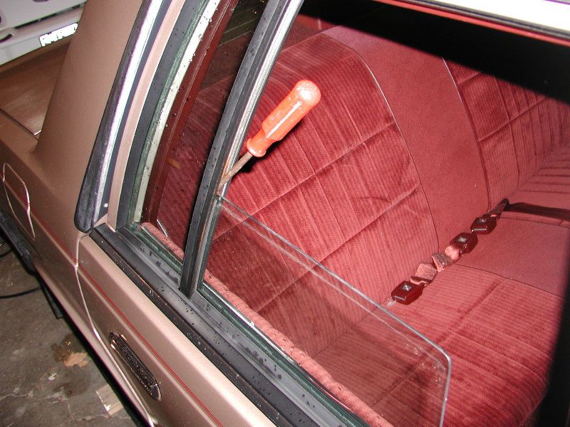

heres a pic
and heres a pic with 2 putty knifes stuck in the window track.
the yellow knife is inserted (about 1/2" deep) between the metal guide and the window. this knife slides up and down like a hot knife thru butter (because one side is glass), and will hit the pin near the top of the window.
the black knife is inserted (about 1/8" deep) between the metal guide and the window channel. its very rusty

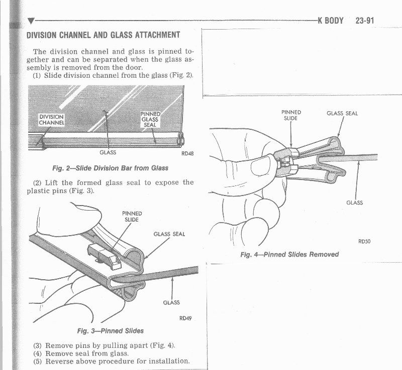

i just looked at the factory shop manual, and the rear window section makes a lot more sense now, it would have been easier to understand if figure 2 had been oriented vertically, rather than horizontally. not the sharpest pencil in the drawer :facepalm:
