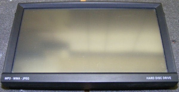

To get the unit to eject, we must first gain access to the loading slot. It is behind the touch screen, so we need to move it out of the way first.
These instructions only apply to the Harman-Becker built REN and RER units. The Mitsubishi built ones, like the RBZ, may be different.
To move the LCD out of the way, gently pull the bottom of the screen forward, as shown, until it stops. You may find a credit card can help move the LCD around without marking it up. Then, push down on the top of the screen in the direction of the arrows until the loading slot is clear.
Electronics Electronic device Technology Multimedia Netbook
Now, we can force the deck to eject. Press seek up, seek down, and audio all at the same time, and it should eject. For the RER navigation unit the button combination is seek up, seek down, and nav. If it does not eject, you may need to remove power for a time.

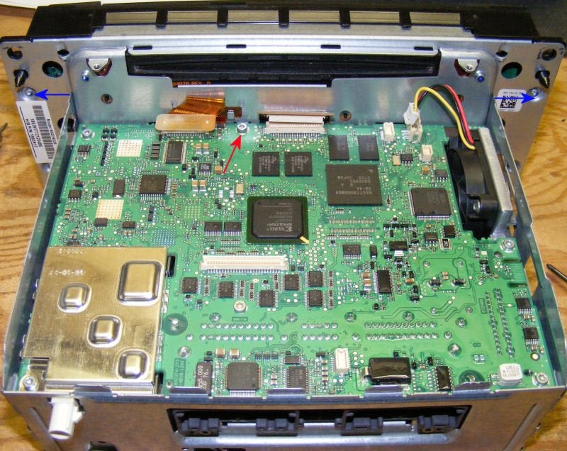

Getting further into the deck, we will now remove the mainboard. Note the blue arrows - those indicate the heatsink mounting screws. It is not necessary to remove those to remove the mainboard. It will come out with the board. Remove all screws indicated in red. Note that the one on the bottom left is found underneath.
Computer hardware Electronic engineering Electronics Technology Computer component
With all screws out, the board lifts out like so. Watch the FAKRA connector (antenna connector) on the back - it has a tab that will try to catch on the metal. There are also two metal pins at the back that hold the board in place - you will have to lift up at the back as well to clear those. The board should come out without much fuss, though.
Motherboard Computer hardware Electronics Passive circuit component Technology
The mainboard has been removed. The fan used in this unit is a Sunon 45mm unit. If this has failed, you will need to remove the heatsink. Undo the two screws I indicated in blue two pictures ago.
