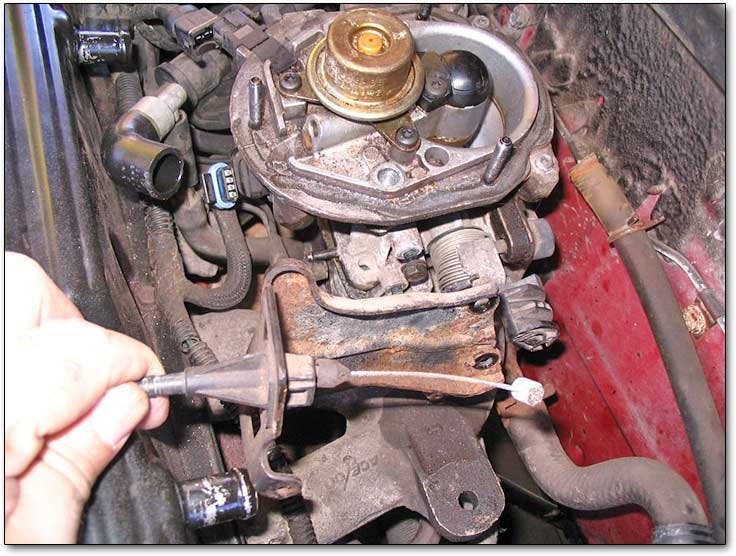

Throttle cable: On the left side, remove the throttle return spring(s), then remove the throttle cable. It will have a slug on the end of it, and to remove, pull some slack in the cable, rotate it toward the firewall and slide to the driver's side to remove the slug from the cable mount. The cruise control cable comes out after it, also sliding to the driver's side. Then remove the two 10mm bolts that hold the throttle cable plate on.

Now, using the 13mm socket, remove the four mounting bolts, two at the rear base and two at the top front of the throttle body. Lift the TB off the intake manifold, remove the base gasket, and stuff a clean rag in the intake to prevent any dirt or objects from falling in.

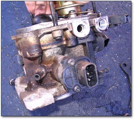

This generation of throttle body has an upper and lower half. The fuel injector, supply and return, and fuel pressure regulator are located in the top half, and the throttle plate with air passages and sensors in the bottom half. Spray some penetrating oil, allow to sit a few minutes, then unscrew the top half with a T-25 bit on the two rear torx screws, careful not round them off. The factory does put them in too tight.

Once separated, you'll typically see the leaky air gasket with gasoline all over it. This was a small air and gasoline leak and does affect mileage and performance slightly. Note the AIS plunger visible above the throttle plate. It moves in and out to add or subtract air from the mixture at idle and on deceleration. The air passage can be obstructed, or the motor's pintle (tip) can stick. On my '92, the tip was stainless steel; by '93 Chrysler had cost-reduced it to plastic.
