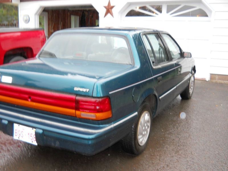

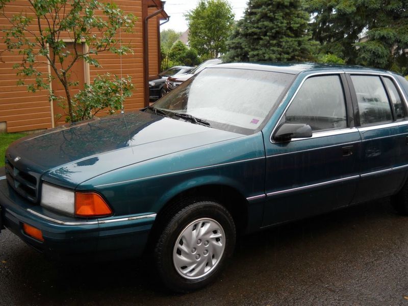

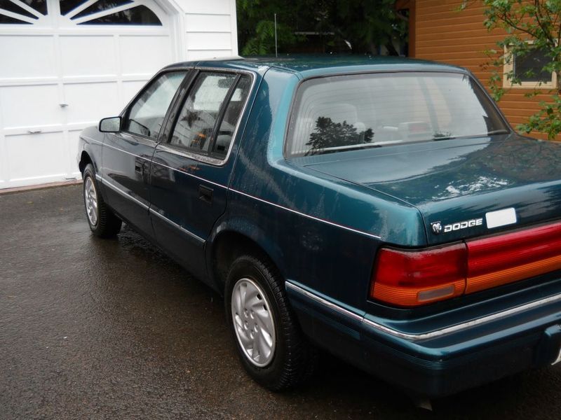

I looked at a low mileage 94 Spirit yesterday. 60452 original kilometers, only 2 owners with some original sales documentation. It's a 2.5, 3 speed automatic. The paint is faded on the roof, hood and trunklid. AC doesn't kick in, it's got a code 22 and the tach seems to come and go. There is no rust on the body but what looks like a soft spot underneath near where the driver's feet sit. It needs the front part of the parking brake cable replaced and a transmission seal where the axle shaft goes into the transmission leaks. It's not currently registered or inspected. What do you think it's worth? I am strongly considering trying to sell my 98 Civic (382000 kms) and buying the Spirit, I've had 3 and I just simply love them.

That Spirit looks like it's had a very easy life. I'm a bit surprised that it could have one area of rust, and not others. Unless the floor pan was damaged in that one spot.
