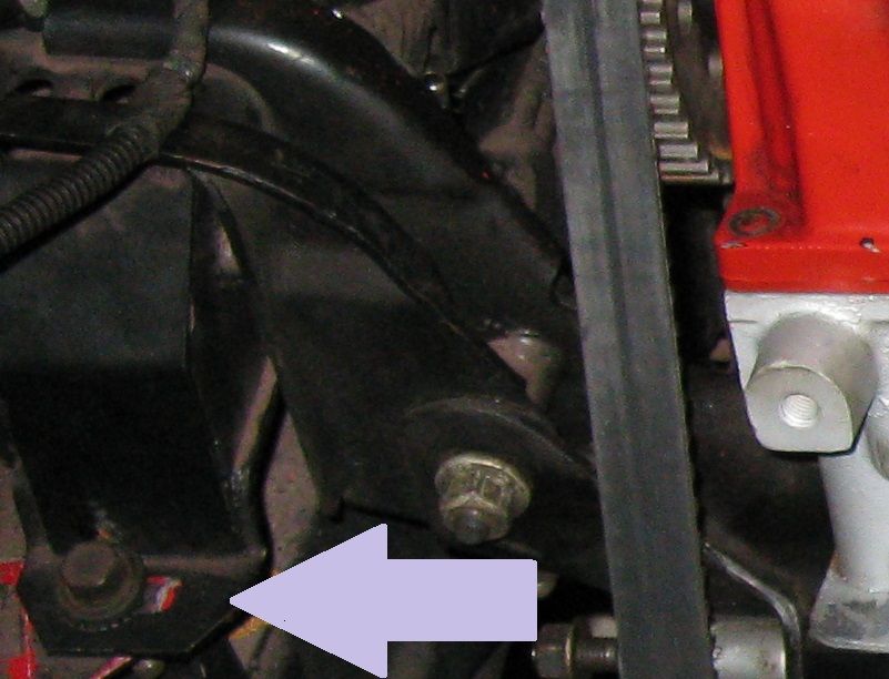

You do have the oblong holes.
We are talking about the motor mount bracket assembly, not the mount itself. As you can see in the picture above, this engine is adjusted all the way towards the drivers side.

Those are the holes I'm referring to and mine aren't like that.
if someone will tell me how to post a pic, I'll put it up. thanks!
747 Posts
I remember one aftermarket mount which I bought did not have slotted holes. I took a Dremmel and made the slots myself. I was then able to move the engine.
