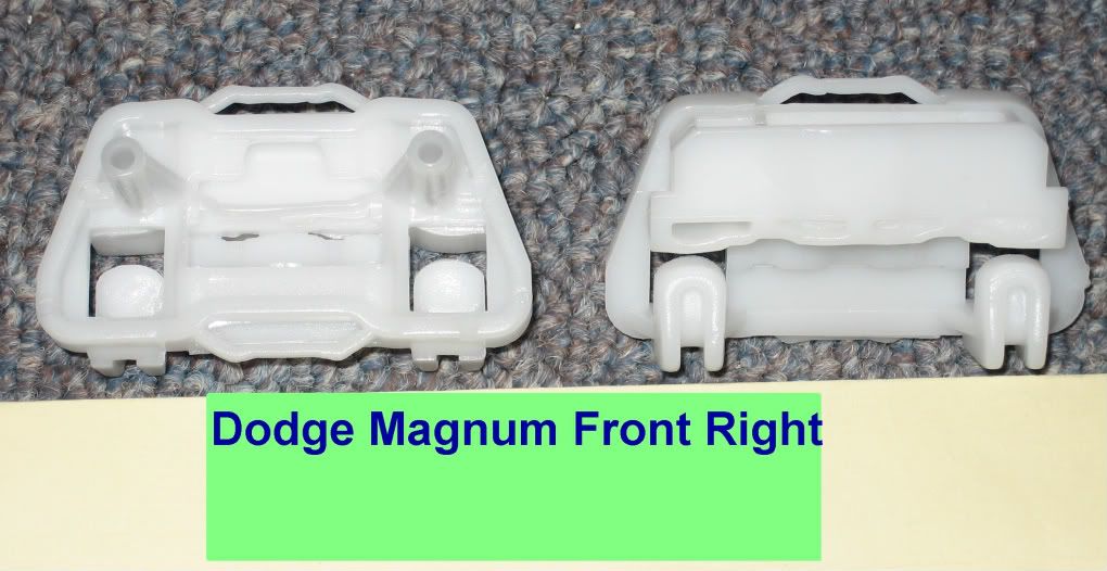

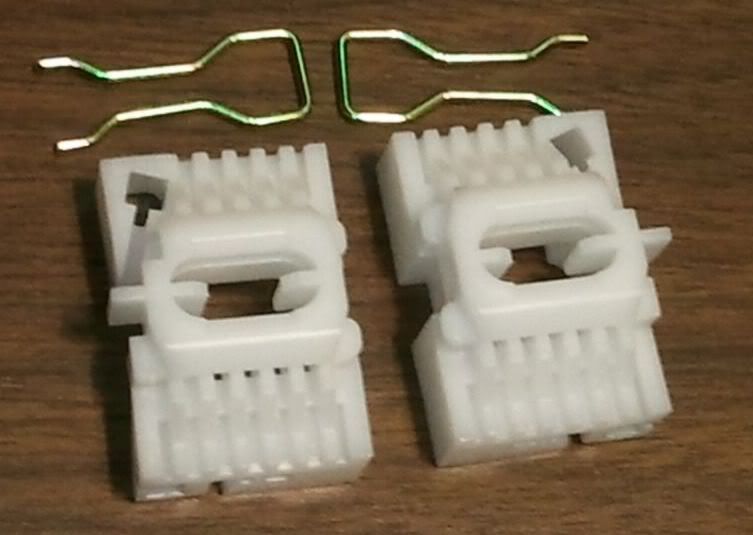

can these be replaced without removing hre regulator from the door?
I posted a question about this today. I need the rear piece. These are on Ebay as well, but I am not convinced that they are selling two different ones. Any advice here would be helpful...

I still need to know about the clips. even if i get an unbroken regulator at the yard, the clips are still 20 or nearly 20 years old and likely to break just like mine.
